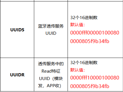

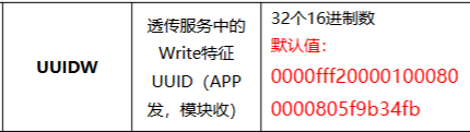

Can youprovide the radrUUID amd CHARUUID that is brodcast please?
Example:
static BLEUUID radarUUID("12345678-1234-1234-1234-1234567890ab");
static BLEUUID charUUID ("abcd1234-5678-5678-5678-abcdefabcdef");
Thank you.
1 Answers
Hello, thank you for your inquiry, pls kindly check the attached pics, which have showed the UUID No. you need.微信图片_20260330114701_90_108.png微信图片_20260330114702_91_108.png
