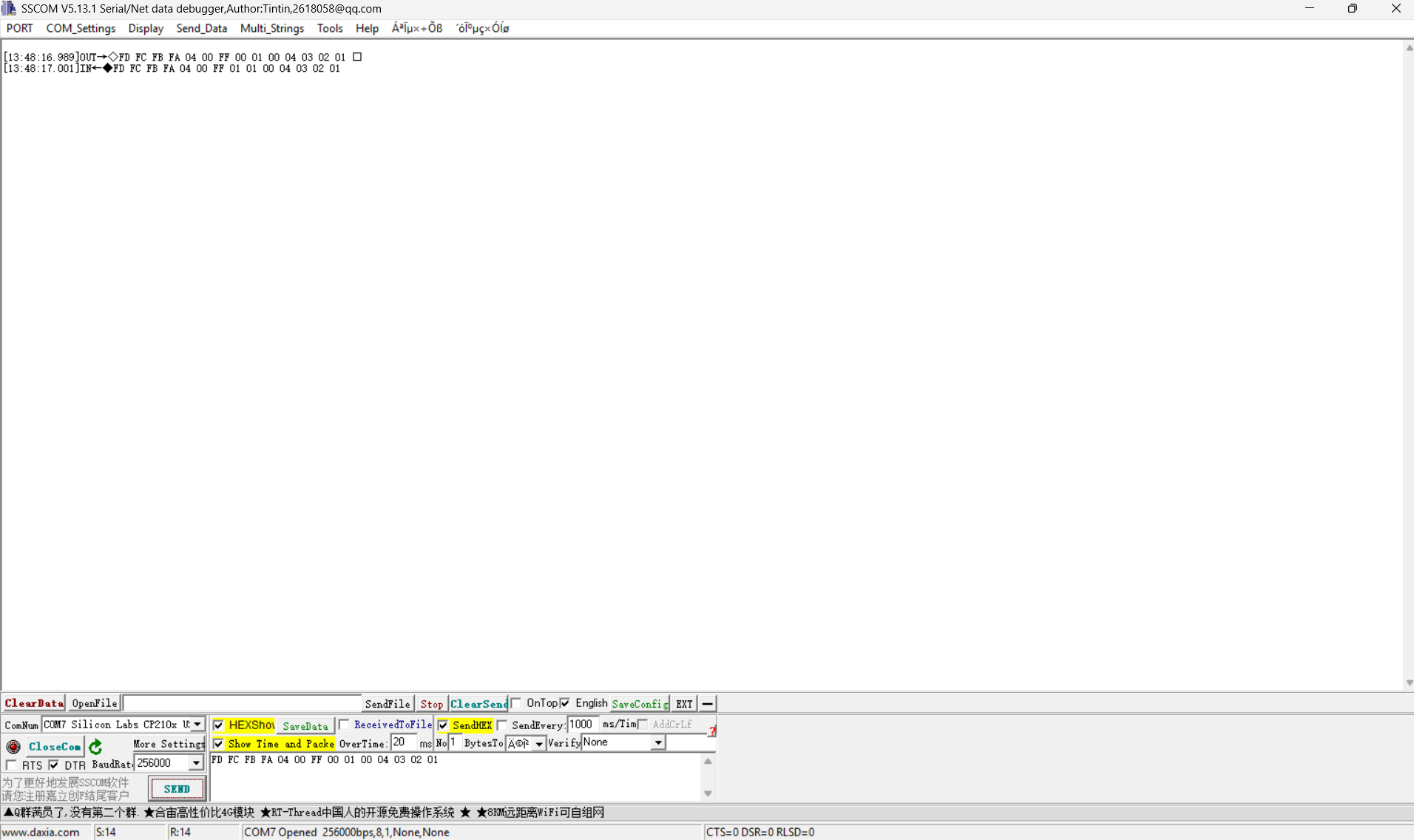

Could you please take a screenshot of the transmitted command for our analysis?
Also, does data transmission stop after you send this command: FD FC FB FA 04 00 FF 00 01 00 04 03 02 01?
Hello,
attached is a screenshot showing the exact command transmitted via USB-UART at 256000 baud.
TX:
The module responds approximately 12 ms later with:
FD FC FB FA 04 00 FF 01 01 00 04 03 02 01
So the module acknowledges the Enable Configuration command (FF 01), but returns status 01 00.
Regarding your second question: the module does not transmit tracking data even before the Enable Configuration command is sent. Therefore, data transmission does not stop as a result of this command — there is already no continuous tracking data after power-up.
The screenshot was taken with the module connected directly via a CP210x USB-UART adapter, without ESP32/ESPHome involved.
