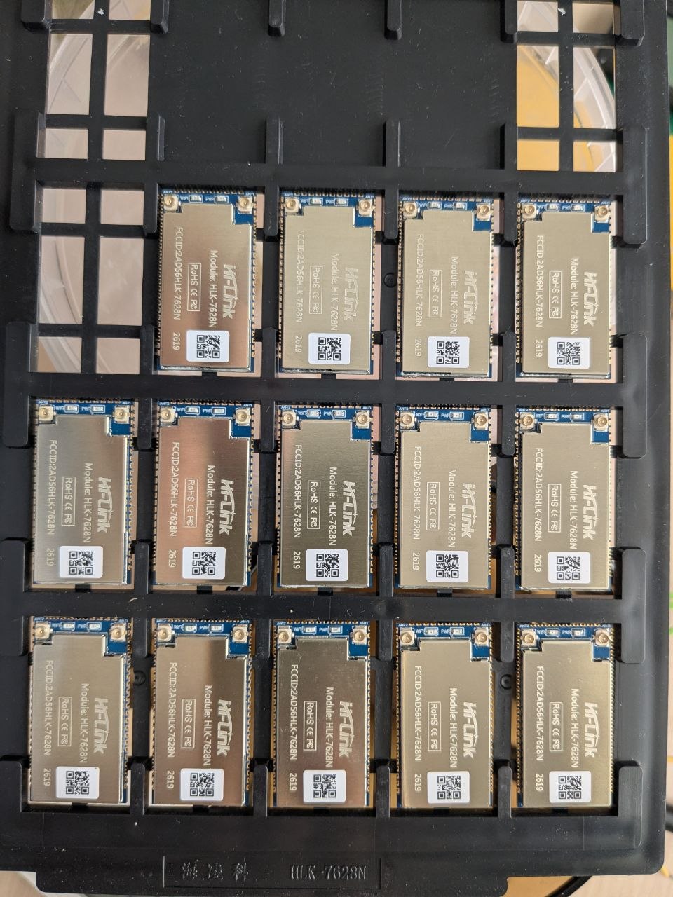

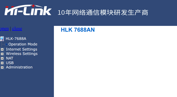

I am using the HLK-7628N module in production. I have a custom OpenWrt image that I used to load via TFTP. The process was initiated through the U-boot console on UART0. Now I have received a new batch of 50 modules in which the serial console is silent, but there is access via the web interface. I cannot determine which bootloader is installed on these boards or how to load my custom image onto them.
1 Answers
Answering my own question. First, hold down the RST button and then apply power to the module. After 10 seconds, the bootloader log will appear, and you can upload your firmware there.
