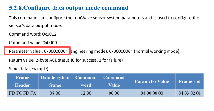

Hello, thakns for your enquiry. checked your issue with our engineer,pls kindly check the updates below:
  1. The main function of LD2402 is to detect human presence and cannot accurately measure distance
  2. Testing of the radar can be done using our upper computer or by reading serial data. The radar can be hung at a height of 1.5 to 2 meters and tested in an open and unobstructed environment.
  3. Pure data reporting can open our engineering mode. pls refer to the attached pic for specific instrutions.LD2402.png
    HLK-LD2402 manual link: https://d.hlktech.net/Mobile/download/FDetail/65.html
