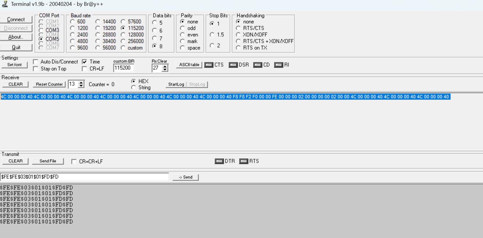

here the frames captured for the firmware command :
4C 00 00 00 40 4C 00 00 00 40 4C 00 00 00 40 4C 00 00 00 40 4C 00 00 00 40 4C 00 00 00 40 4C 00 00 00 40 F8 F8 F2 F0 00 00 FE 00 00 00 02 00 00 00 00 02 00 00 4C 00 00 00 40 4C 00 00 00 40 4C 00 00 00 40

Hello, thanks for your inquiry. our engineers have updated relevant solutions for your issue, please check your email.
