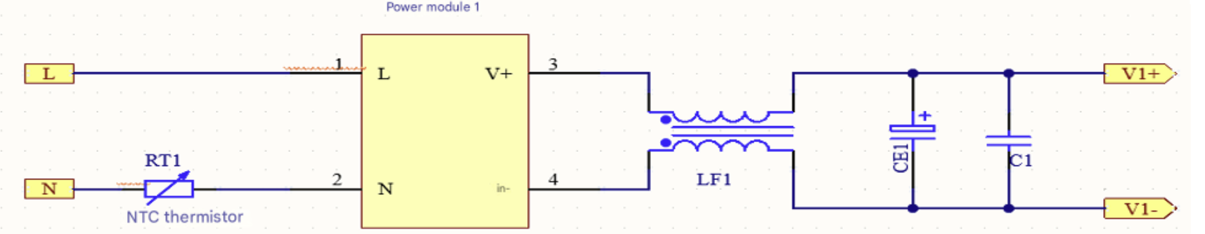

What common-mode inductance does the HLK-50M-12 use?
Viewed 70
I plan to use the HLK-50M-12, so please recommend a compatible LF1 as shown in the picture.
I would like it to be easy to find and affordable.

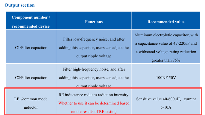

The HLK-50M-12 is 12V, 4.2A. Shouldn't the saturation current be greater than 4.2A?
