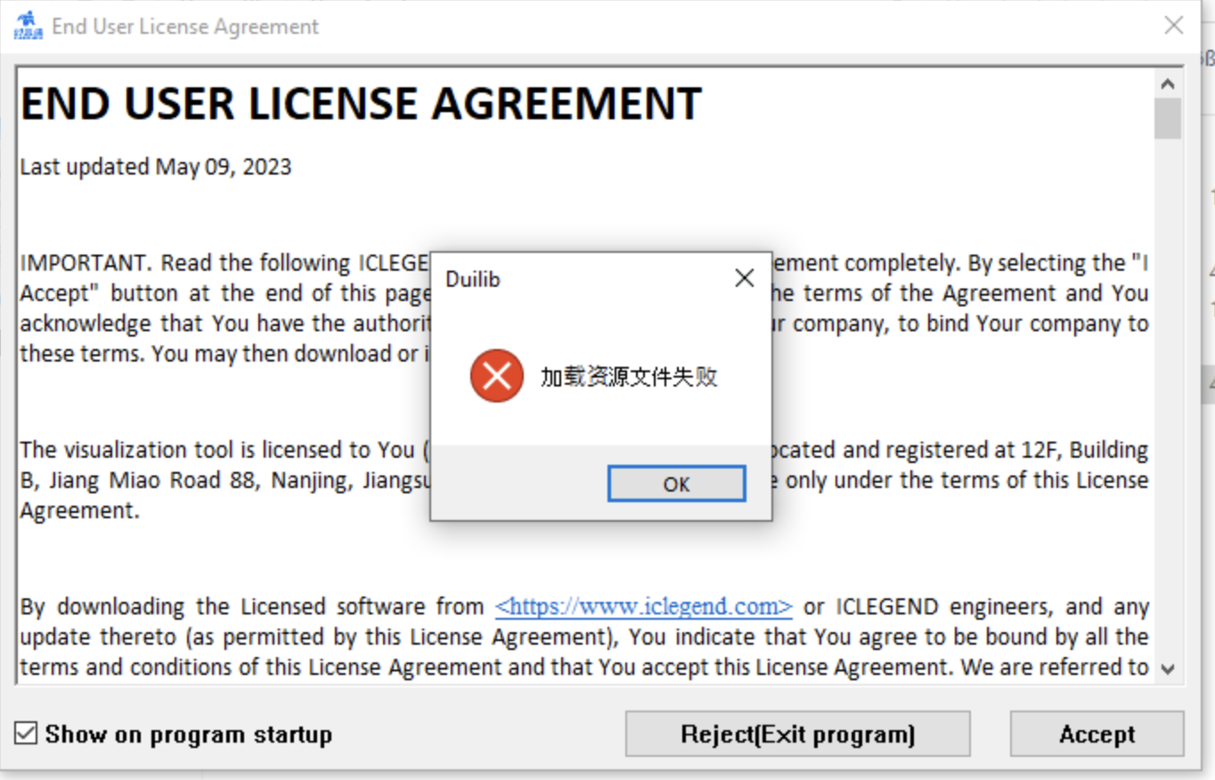

Unfortunately, I don't have access to Windows. Do you have a test tool for Linux? I don't need a GUI; a command-line tool is fine too.

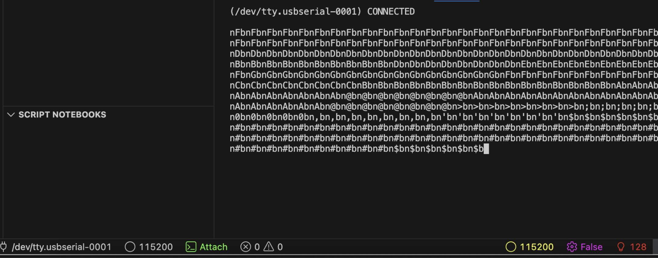

I tested the sensor with a TTL USB stick and a PC serial console, and the output is very rudimentary:
I also tested an LD2410C sensor with Pico2 and UART and the output is correct and matches with "Reported data formats" specification.
f4f3f2f10d0002aa0256000056006446005500f8f7f6f5f4f3f2f10d0002aa0256000056006446005500f8f7f6f5f4f3f2f10d0002aa0256000056006446005500f8f7f6f5f4f3f2f10d0002aa0256000056006446005500f8f7f6f5f4f3f2f10d0002aa0256000056006446005500f8f7f6f5f4f3f2f10d0002aa0256000056006446005500f8f7f6f5f4f3f2f10d0002aa0256000056006446005500f8f7f6f5f4f3f2f10d0002aa0256000056006446005500f8f7f6f5f4f3f2f10d0002aa0256000056006446005500f8f7f6f5f4f3f2f10d0002aa0256000056006446005500f8f7f6f5

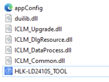

Your demo tool won't start (duilib.dll).
Tested on Windows 10
Files in directory:
Hello,please note that the demo tool is not supported on Linux. If the issue persists on Windows, kindly send your feedback to info@hlktech.com, and we will send you the updated test tool as soon as possible.

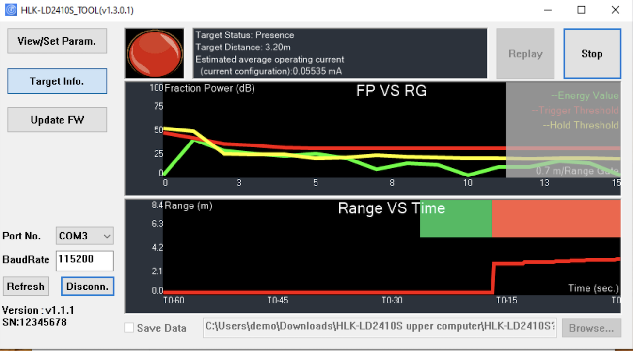

the sensors work with the yours native software on Windows 10 over usb ttl.
Could you check if the protocol for these sensors is correct when using UART?
I can also try testing the UART data via ESP32.
However, it would be good to know why the output to UART (on pico2) isn't providing the correct data.
