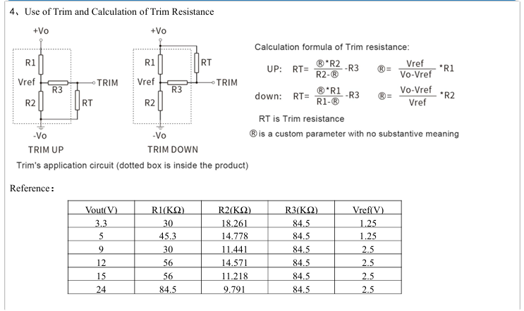

I want to use the URB2412LD-30WR3 modules in an application that needs relatively exact voltages.
I need a resistor/trimmer network that allows me to trim the voltag up/down +/-2%. How Do I find those Values?

Hello, for you question. pls help to check the attached pic,if you still need the manual, pls contact the email: info@hlktech.comreference.png
