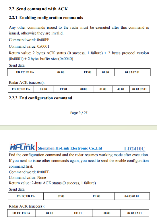

Hi I am using the LD-2410C v1.0 with firmware v2.04. Is this module only configurable through bluetooth? Because I can see everything on the HLK app, but when I try to configure the module using serial UART I am not getting any ACK back. I do get the radar output correctly, though. So I'm quite sure that the connection is fine. Please advise. The manual available on the website for this sensor is just up to v1.08.

You can configure the module with serial port through sendinge enabling configuration commands, please refer to the attached pic to fonfigure it.LD2410C.png
For the mudule protocol manual, pls help to click this link: https://d.hlktech.net/Mobile/download/FDetail/74.html
