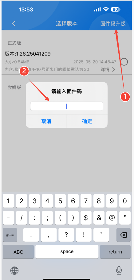

I recentlty updated LD2412 to V 1.26.25041209 but it does not work well with my integration. I need to get back to V 1.24.24080517 . How can I downgrade the device?

The firmware V1.24.24080517 have been uploaded in the App, upgrade through the app by connecting the module, clicking on the firmware code, and entering NUNIXB to upgrade.
The docs of HLK-LD2412 also have been uploaded in this link (https://d.hlktech.net/Mobile/Download),
Attached is the upgrade steps, please kindly check them.
