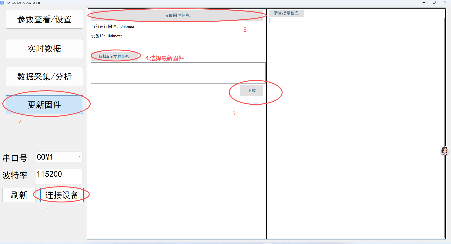

Hello, Sorry for the mistake in my last message. The latest firmware version is 1.6.1. Please follow the steps below to upgrade it.
1→Connect the device
2→Update firmware
3→Get the firmware infos
4→Select the BIN file path (choosing the latest firmware )
5→Download

The HLK-LD2420_TOOL software can install the firmware on the LD2420. That is the "Download" button you mentioned above. The download button is not for downloading the firmware. When you press the button, you must already have selected the firmware.bin file we are searching for. And this file cannot be found in the HLK-LD2420 section of the above-mentioned download link at https://h.hkltech.com/mobile/download.
What all users here need and are looking for is the file with the firmware that has the extension .bin.
