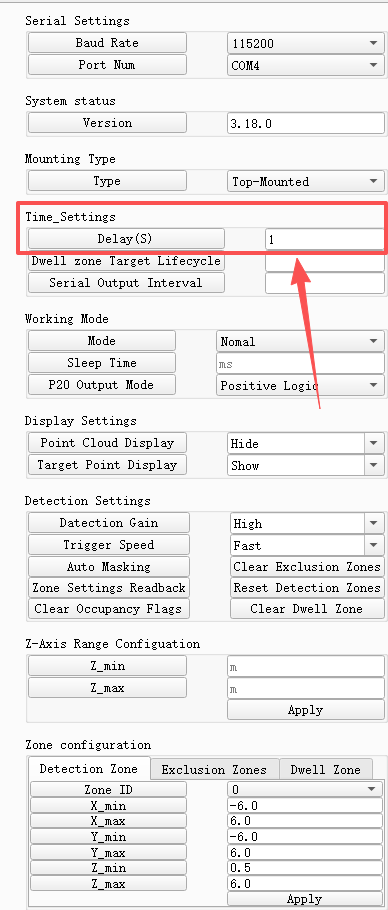

Здравствйте. Скажите Вам удалось получить новые прошивки?
Hello, thank you for all your questions. Sorry I haven’t been able to reply recently as I cannot log in to WhatsApp.
I have consulted our engineers regarding your inquiries. Please refer to the solutions below:
  1. Our latest firmware version is 3.18.0.
  2. Discontinue using the UART testing tool; instead, use the upper computer testing tool or the radar App. Please note the delay setting and adjust it to 1 second.
We will continue to follow up on your issue and look forward to your updates.upper computer screen.png
